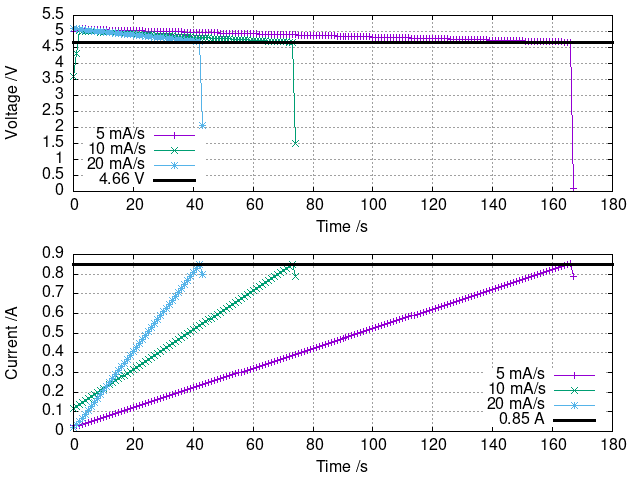

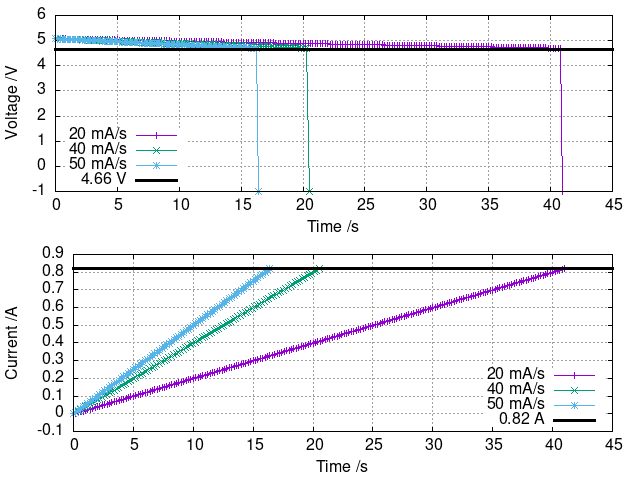

HG Updated by Henrik Grimler almost 5 years ago Actions #6
i9300 running replicant 6 can provide around 820 - 850 mA to an OTG device. I measured it by sweeping the current from 0 to 1 A with two different galvanostats, with some sweep rates between 5 mA/s and 50 mA/s, and aborted when voltage reached below 4 V.
It seems that it might be the voltage rather than current that decides when the OTG power is turned off, once the voltage drops to 4.66 V the connection is terminated. When I tried with two different galvanostats this corresponded to 820 mA and 850 mA, respectively. It is a bit weird that the two instruments gave different values, I will need to run some diagnostic tests to see if there is an issue with one of the galvanostats (I trust the one that gave 850 mA the most).
As far as I can tell these are hard limits, trying to draw 820/850 mA will turn off the power, but at 5 mA below that limit the phone can provide power continuously (at least for 30 s) without issues.
The battery in my tests was charged to around 50 %, being at 100 % or 5 % might give slightly different results.
In the attached graphs you can see how the voltage changes with current, and that it turns off once the voltage reaches 4.66 V. It is a bit hard to see from just the plots, but the voltage drops linearly with increasing current. The raw data shown in the plots can be downloaded here.
